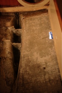

The Inner Laminate
Overview
Note the core bonding agent you see toward the back of the keel (clearly visible squares). This stuff is relatively soft and filled with moisture. After a week of drying, the core bond still read 400+ (out of 1000) with the Aquant meter. With a quick belt sanding down to glass, the moisture reading is in the green again.
