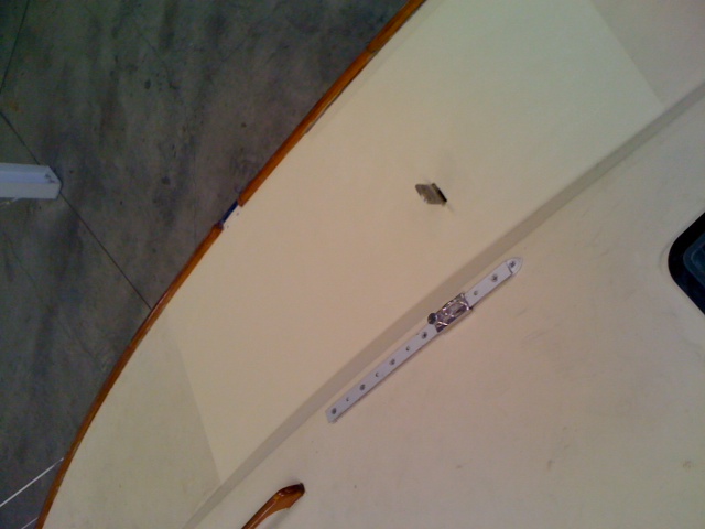

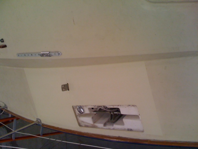

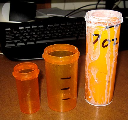

Wait ... you should have as many of these free measuring devices as I have.
the middle one is used for penetrating epoxy ... 2:1 [but a little less in 85 degrees]
the big one is used for the interdeck paint: three shooters of white, one of gray.
but gray paint is not rocket science ... no more of a problem than epoxy.
What you don't want is a gray that under 90 degees is too hot.
Here also is Vee Jay gray done last weekend on a 1978 J24 we are working on for the kids this summer. Notice the starboard white filler panels on the bulkhead ... this is interdeck 3 parts white to 1 part of their standard gray and a good match for the deck color from 1978 just a shade lighter to further reduce the long hot summer day effect.

Measuring devices, assorted sizes for J30 work

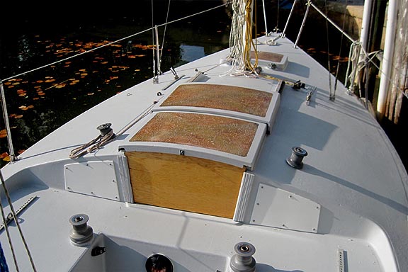

I recored an area on Madcap's side decks last winter. I had a hardware store tint the white Kiwi Grip to my deck color and it turned out great. The cream color from Kiwi Grip was too far off my deck color.
Outside and washed it is a very good match. Ill do the rest of the deck someday, but for a patch it worked out great.
It is an excellent product and very easy to apply.
