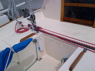

Well it's that time of the year again to start more off season maintenance projects. I decided to fix the wet core below the port primary winch - and start it two days before hurricane Sandy.
Here is a teaser photo:
[Linked Image from 2.bp.blogspot.com]
Here is the latest Blog post link

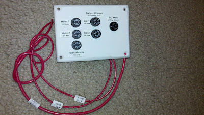

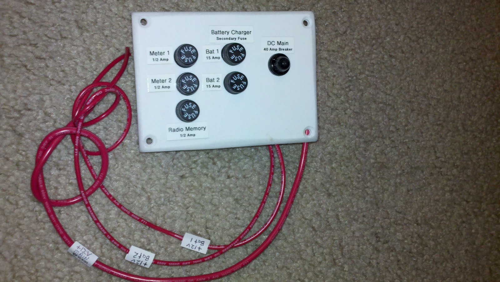

Another Rhapsody Blog update. More on the port primary winch area recore, started on port bulkhead repair, and some electrical work.
Here are teaser photos.
[Linked Image from 3.bp.blogspot.com]
[Linked Image from 4.bp.blogspot.com]
Go to the Blog for details.
This weekend I completed installing the new chainplates to compensate for the port bulkhead that was wet near the top, but now filled with thickened epoxy.
Below is a teaser photo. Please see my blog post to read the details.
Original (shorter) - New Starboard (longer)- New Port (longer & Wider)
