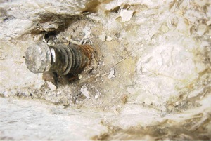

Keel bolt eroded and unhappy. I’ll be doing something like this
sailnet.com article.
The threads you see further down are actually so eroded the original nut spins on them. This sucker is DONE.

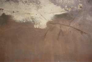

Cracking on the side of the keel from the rotten keel bolt. Rust indicates corrosion and water penetration.
