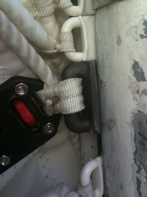

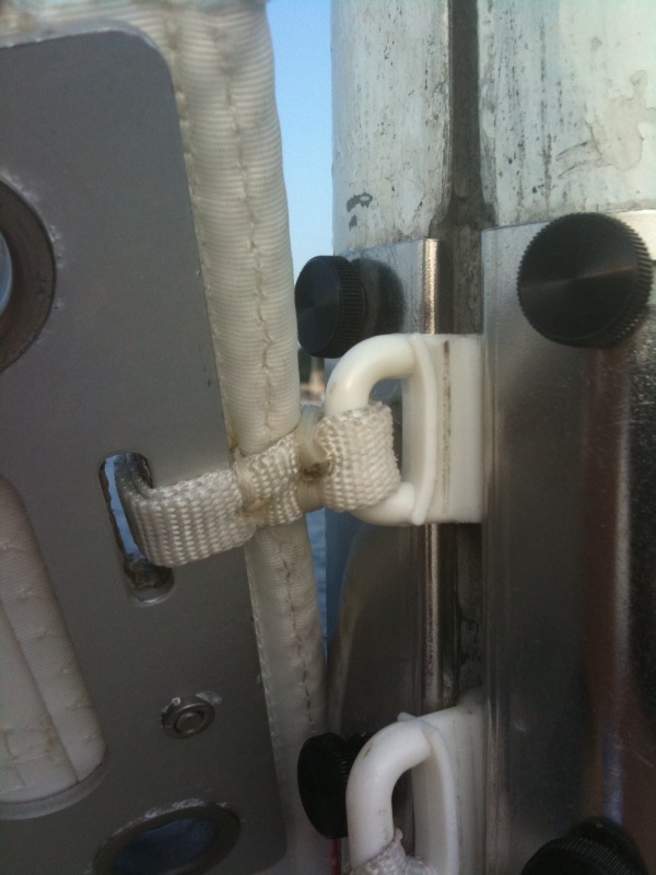

Here are a couple of pics: First is of the regular slide, the second is of the side that is at the top batten. The slide opposite the batten car gets caught in the gate, the others do not but since we always jump from the mast you just guide it through, all the others are fine.
