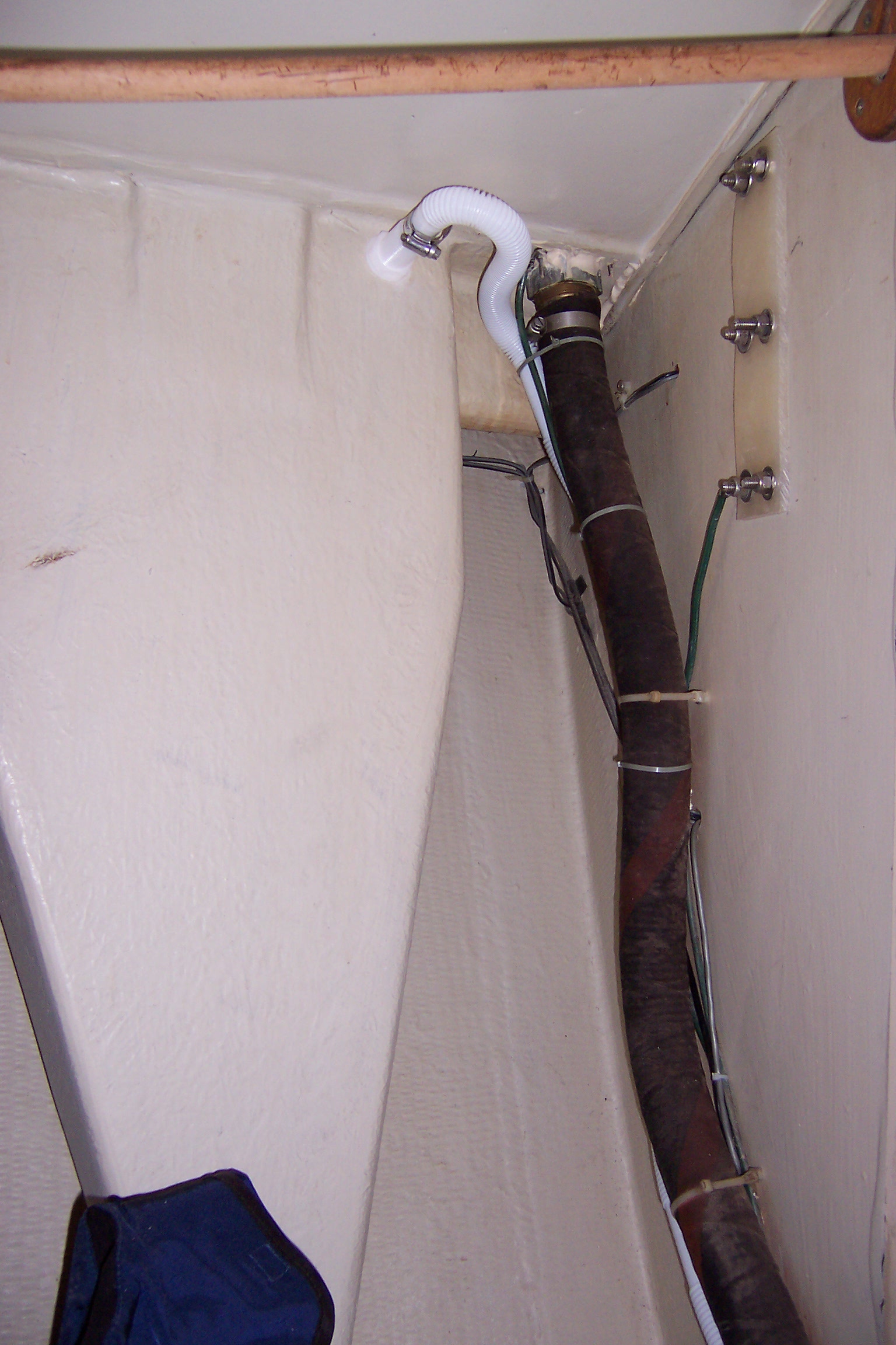

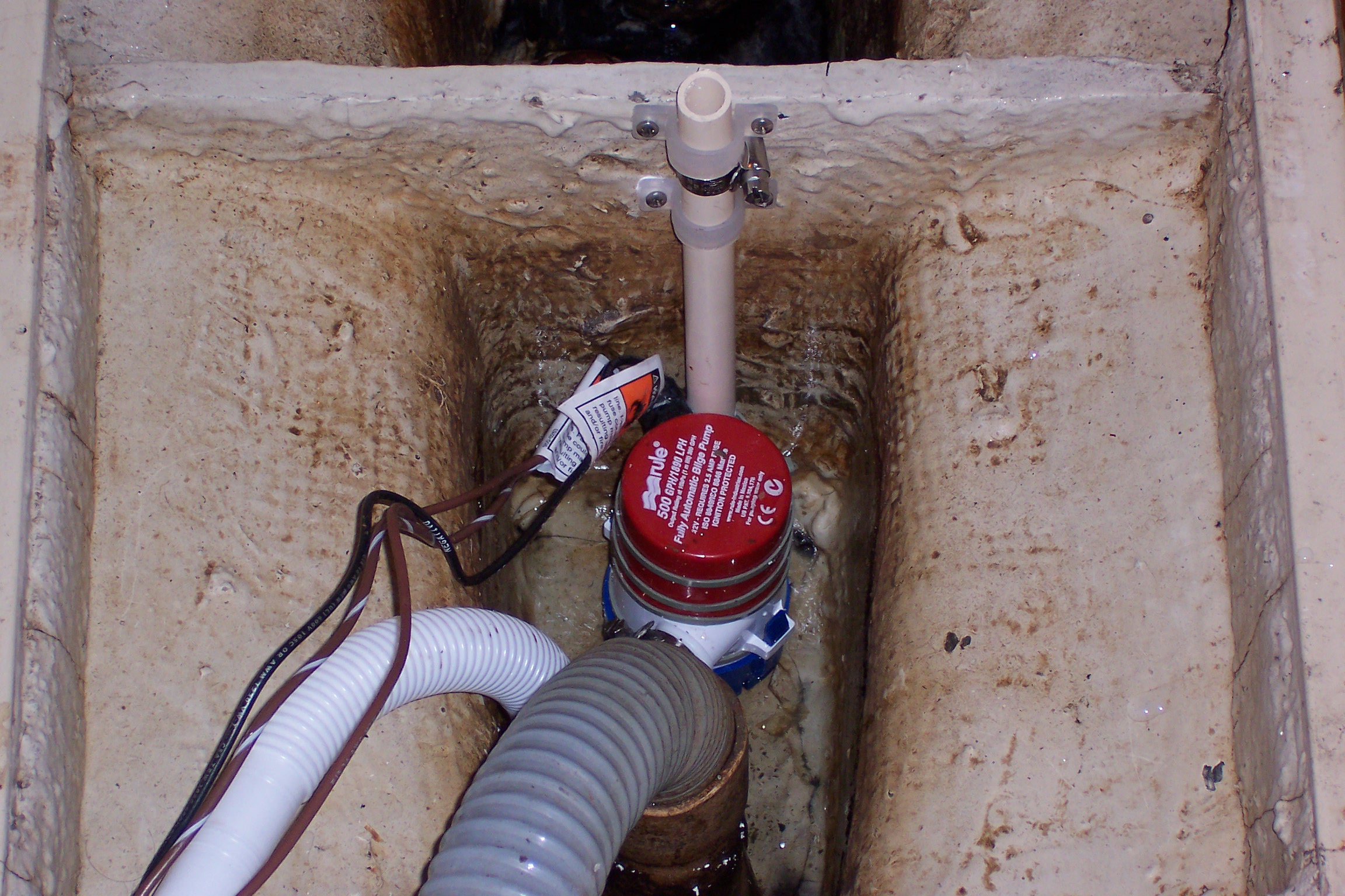

Finally mounted a bilge pump (note i first started talking about it in June 2008  As mentioned before, I have 2 water talks on the port side, and I verified that there is no going under them with a hose. So I routed my 3/4" hose up the starboard side (note that even then, the flex house would not fit, so I used plumbing hose for that segment). From there, I just go forward to the hanging locker, up and to a thru-hull at the top of the anchor locker. So the water just drains down through my fixed anchor locker drain. I figure this is good for the following reasons: -no anti-siphon needed -no new holes in hull -shortest possible hose length -if anchor locker drain clogs, no problem, it will be very obvious at next visit to the boat I mounted the automatic pump using methods I found here on the list. Ive attached some pictures -dan ![[Linked Image]](https://j30.us/ubbthreads/ubbthreads.php/ubb/download/Number/411/filename/100_3497.JPG)
