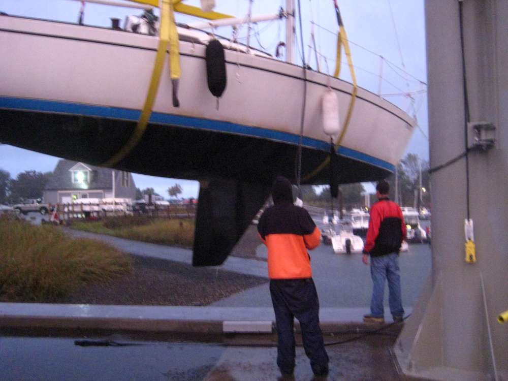

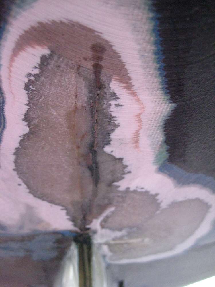

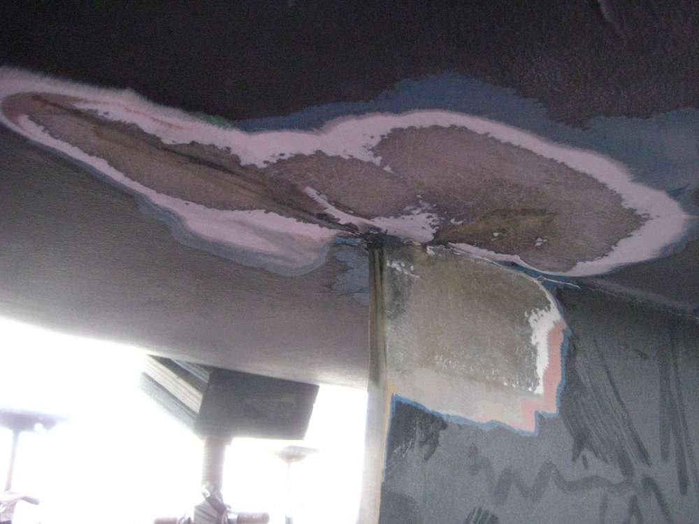

Attached are some photographs that I took before the damage was sealed up enough for her to be delivered (by water) down to Larchmont Yacht Club after the 2009 NA's. The first is of the damaged area and the second is the joint in the hull leading back from the hull-keel joint. The last is Triple Play hanging in the sling at CPYC before being put in the water after being "repaired".
Anyone interested in this boat should have the whole area checked over with a fine tooth comb by a surveyor (as you would anyways)
