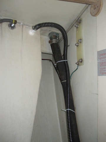

Dan:
Thanks for posting the pictures and supplying the info. I started the installation process this morning. The main difference from your installation is I used an upgraded exhaust hose that has no internal ribbing. It was slightly more expensive. I, too, had to drop down from a 3/4" hose to a 5/8" section to allow it to run from the bilge up into the starboard aft settee. It was a tight fit and the 3/4" tubing couldn't be persuaded to squeeze through the tight fit.
Total cost for materials, if anyone is interested, was about $200.00. I installed a three-way switch (auto, off, and on) with a light.

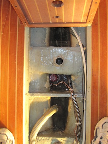

I just finished my bilge pump installation. I used a Rule pump with a built-in float. A word of advice...test your pump before installing it. I had a defective new pump that wouldn't work in the automatic mode. It took many hours of tinkering with connections, etc. before the yard technician and I figured out we needed to test the pump.
My installation is essentially like Dan's except I used a smooth hose that is stiffer than the white bilge hose. As a result, I was able to jam the pump in the bilge without having to screw the base into the bilge or concoct the fiberglass rod gizmo. Also, I installed the check valve about one foot or so from the pump. If I can upload some photos, you'll see it.

Motivated by these write-ups and the fact that the last two winters have left my bilge filled with a solid block of ice I set about installing an automatic bilge pump this past weekend. Rule 500 25s automatic which I have used before on skiffs and a check valve from West Marine, plus 10 feet of 3/4 vinyl braided tubing, stainless clamps, and the dishwasher fitting used by Rhapsody from Home Depot.
10 feet was not enough tubing. I had some trouble fitting it through the aft port scupper but succeeded. Only problem is I can fit either the new tubing or the whale gusher hose in the bypass under the floorboard but not both. I wondered whether I could cut another grove opposite the one for the whale gusher without impacting the keel structure.
I'd prefer to use the forward port scupper but could not seem to fish it under the water tank, plus this scupper was plugged up more than the aft one.
My late model hull (481) has an 90 degree elbow with a screw fitting for the drain just under the main cabin sink. So the dishwasher fitting did not fit. On top of that I could not release the flexible hose from the elbow and was afraid I might sink the boat if I cut it, there being no valve on this through hull. Head sink is metal and also has an elbow just below the drain. I'm thinking I could somehow still use the dishwasher fitting under the main sink beyond the elbow. Or I maybe I have to consider the anchor locker option, though I would need to vent it and splice in a T since I don't want a stream of water flowing past my anchor. Any other ideas?
Originally Posted by Bob Rutsch
.... Only problem is I can fit either the new tubing or the whale gusher hose in the bypass under the floorboard but not both. I wondered whether I could cut another grove opposite the one for the whale gusher without impacting the keel structure.
Since the new hose is on the discharge of the pump, it doesn't need to be as rigid as one on the suction side like the long one to the whale gusher. Try some of the cheaper white plastic bilge hose with the accordion style ridges. You could use fish tape and get it under the water tank through the forward port scupper. If needed, use a rasp or long drill to open up the scupper. There was also a little play on the Rhapsody water tank that allowed it to move enough to help fish the hose underneath it.
Use a pipe wrench on the hose at the sink end to see if you can break it loose. If you need to cut the hose, the through hull should be above the waterline if you force the boat to list to stbd. I've done that by taking a halyard to a dock cleat on the stbd side.

I too have the extra water tank on my port side and was able to run the bilge pump hose under the tank. There is a slight amount of play under the tank that allowed me to run the discharge hose. I used a batten to thread a small line as a messenger to help route the hose. It was really easy to run the discharge to the sink hose. I used the same path to route the wires and installed an on/off switch with an inline fuse under the sink. I installed a auto float switch with the pump, the on/off switch to turn the pump off while sailing.
After what I had read in the J-30 forum I assumed that I wouldn't be able to get the hose to fit, but the Red Head (Cynthia Ross) said she had no problem with running the hose under the tank, so I gave it a try. As usual she was right.
