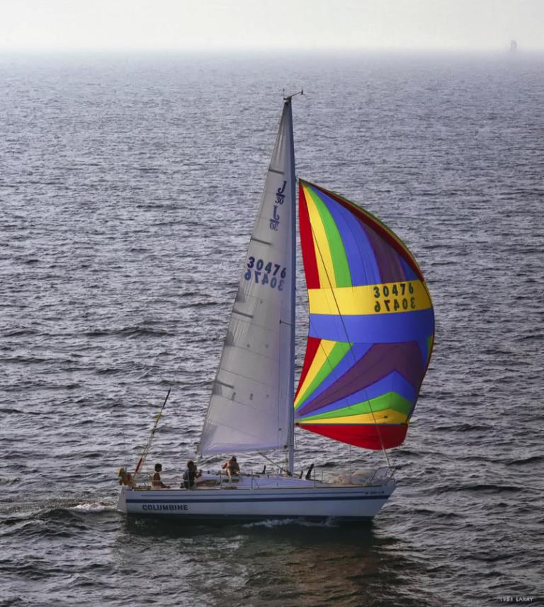

A post by Larry on Sailing Anarchy sent to me by Dennis Bartley has a great picture of the J/30 Columbine in the 1983 Mac race. Based on the sail number, it is hull 207 Koeshtkah now owned by Doug Marshall.
Columbine. Harry T. Colfer. MBYC. J30. 1983 Chicago to Mackinac Race. IOR Section 5, rated 25.7.
