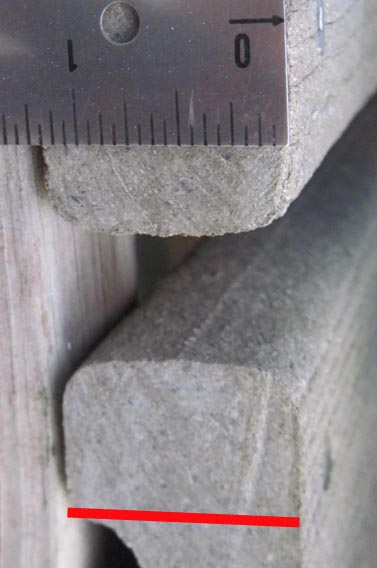

So OK this is NOT a picture of the existing rails ... but I am in the process of moving a 1978 J24 back into service as a novice keelboat training platform. And am exploring cheap alternatives. The j30 rails are about 1/4in. larger than J24 rails and set up as a trapezoid. You do not want to use current dimensions to build new rails as with sanding and wear I'm estimating they loose about 1/16 in. every 10 years ... worse case could be 3/16 short in height and 3/8 short in width.

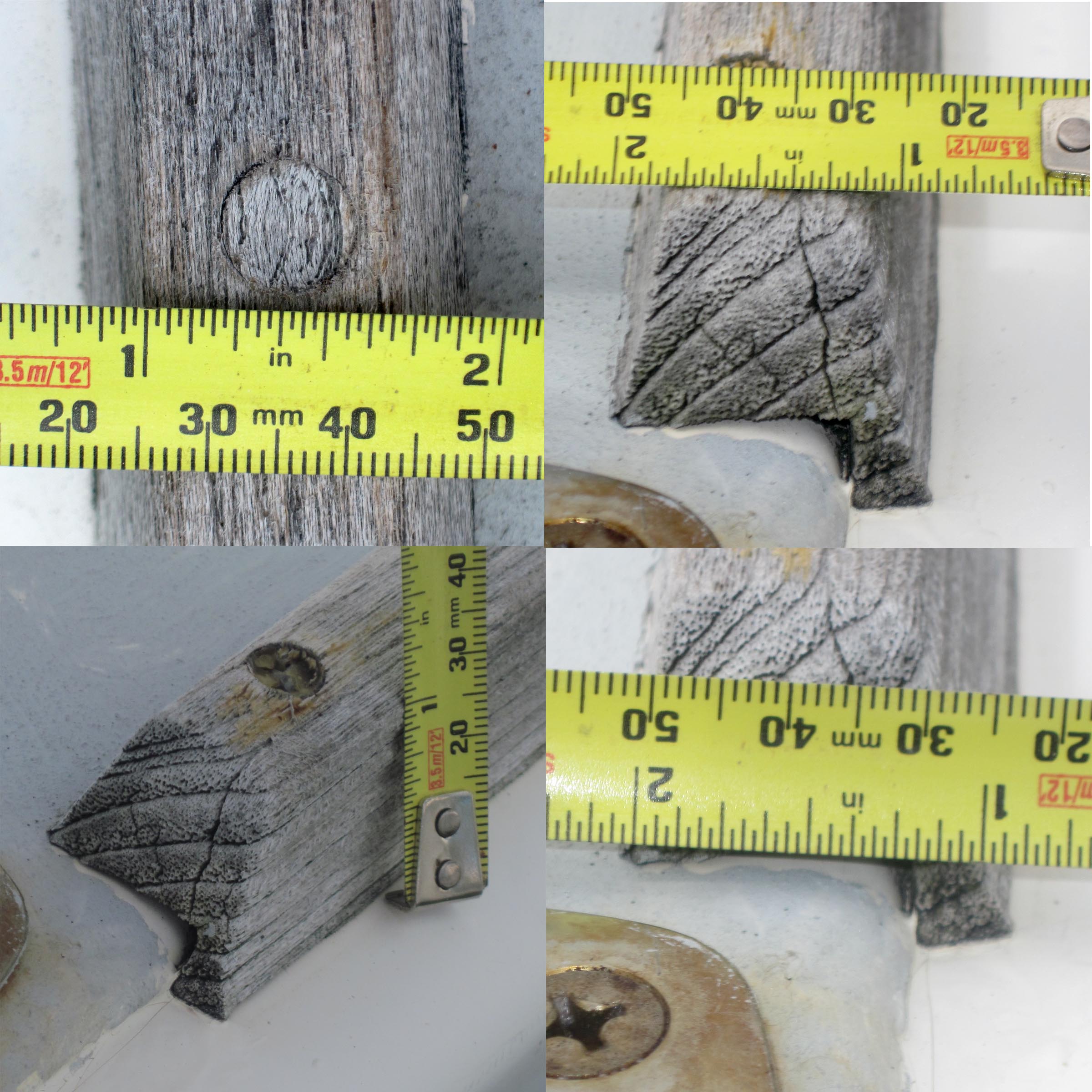

Boat repairs last year included replacing one starboard teak toe rail. I'll be back on the boat this weekend and will try to get some demensions and picutres
So Ok ... remember that some of us senior set start reading a metal rule at 1 in. and do so also upside down. duh...
