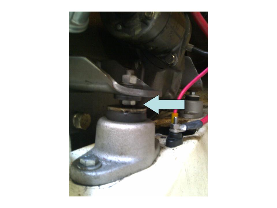

Thanks Bill, here's a pic of my mount. The arrow points at the place where I can separate the mount in to two pieces by jacking up the engine. I didn't expect this and am thinking that its not the way it should be....

Corey - I can't tell from the picture if the stud is actually sheared off, or it is just adjusted at that height to level the engine. The stud should be one piece firmly embedded in the rubber. It should hold the engine on the rubber mount so that all vibration and motion in all directions is attenuated by the rubber and transferred to the boat.

and that's what I expected as well. Will get them out to see if they've sheared or if my mechanic took a "shortcut" mad

I have those mounts and they are supposed to be moulded one piece, same as a car. I have a spare for my boat and it is solid. Greg
