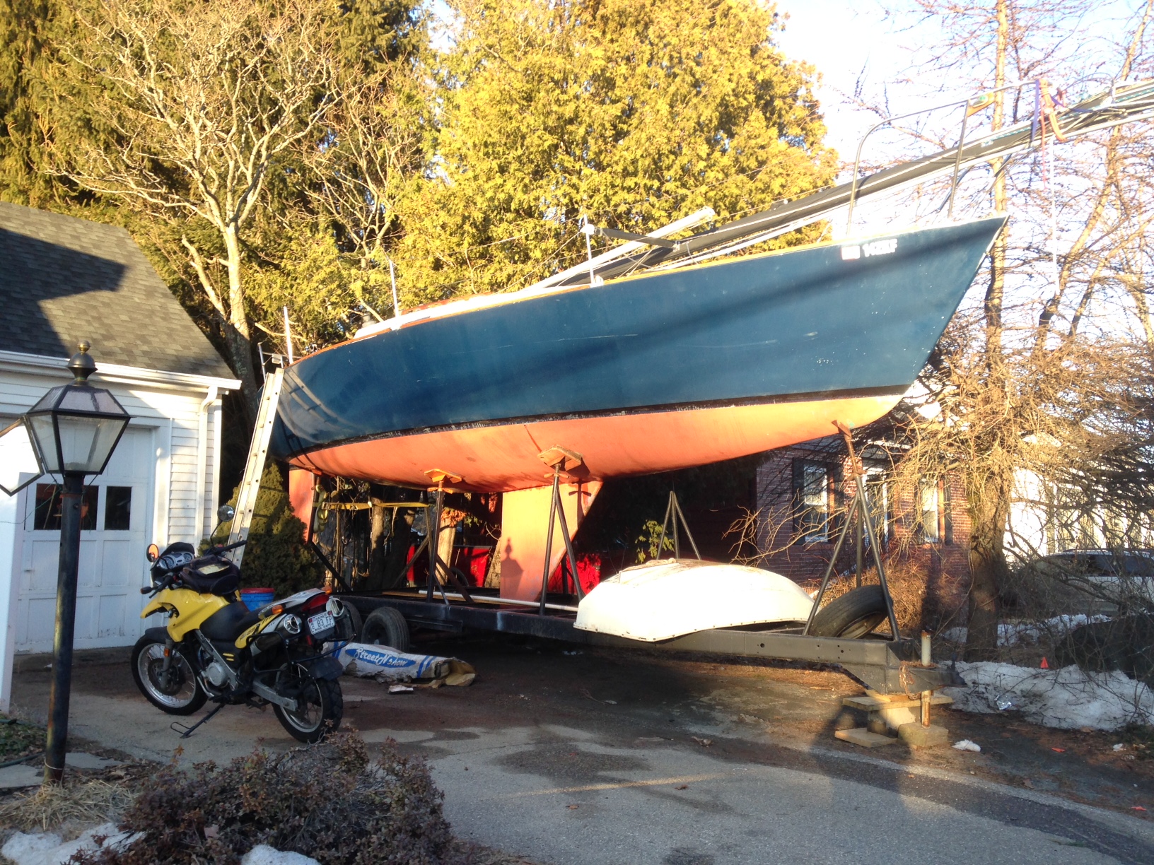

Well the sun was out and temps climbed above 40 degrees so spring must truly be on its way up here in the frozen north. To celebrate, I removed her winter coverings and let her deck see the sunshine once again.

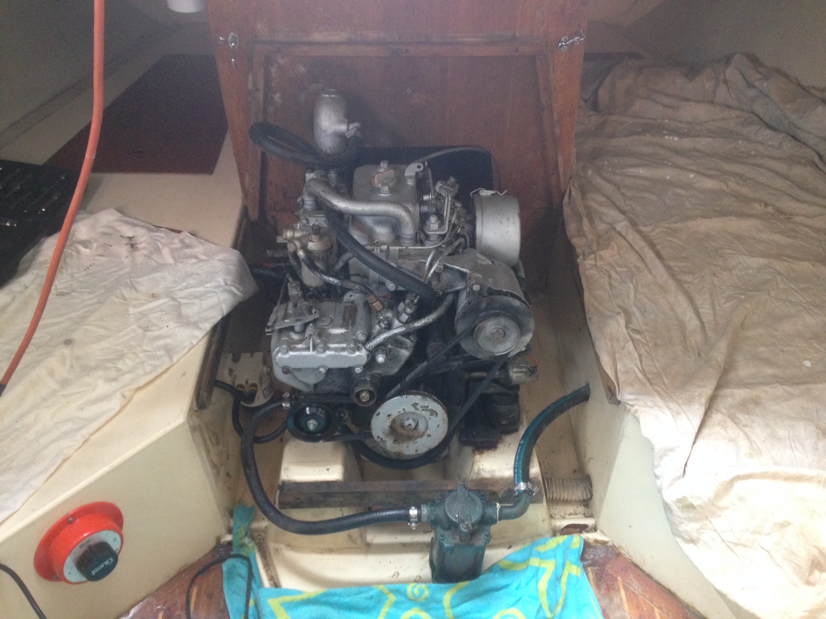

On the agenda to be completed before our May 1st launch is some engine surgery (I found this which makes me feel confident), rebedding stanchions and various deck hardware, cabin heater install, new kiwigrip, sheave box maintenance, mast lighting replacement, waste hose replacement, cutlass bearing replacement along with the usual bottom paint and bright work maintenance so it's looking like I've got a busy month ahead of me.

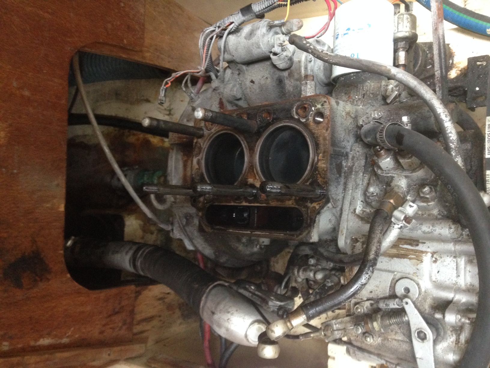

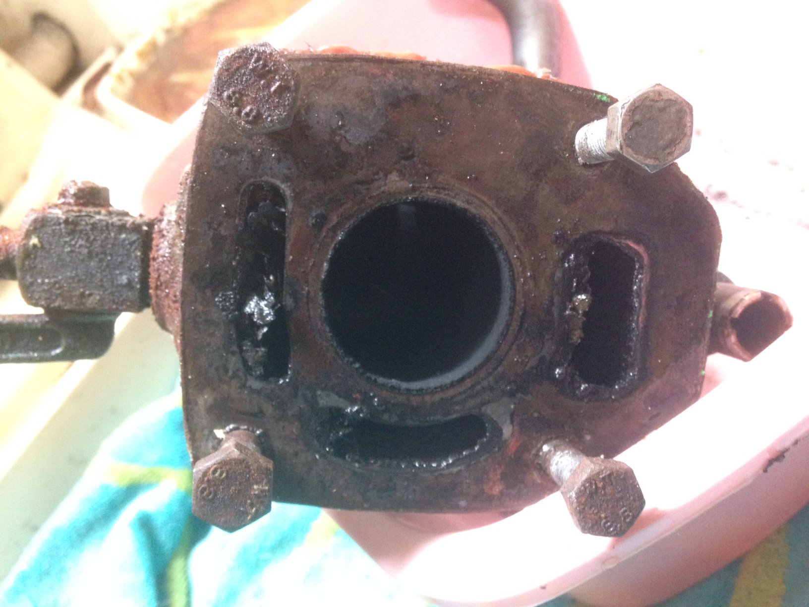

So I've taken the plunge and will be pulling my yanmar apart down to the cylinder head, grinding and reseating the valves and cleaning the scale out of the exhaust manifold and cylinder head cooling passages. I have the exhaust manifold off and can see plenty of it along with some carbon buildup. What would you use to clean out the passages, get what I can with a wire brush and flush with water or do something more drastic like muriatic acid?

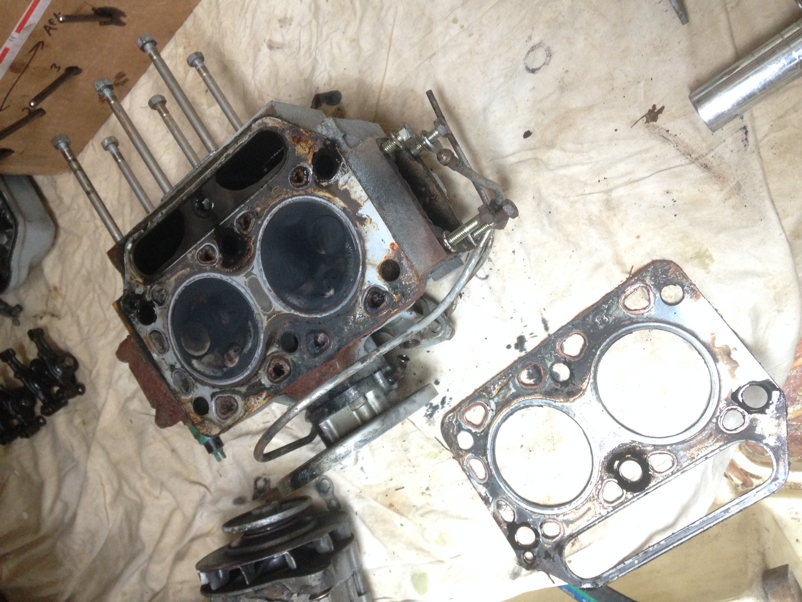

and deeper we go
until we finally have the cylinder head off.

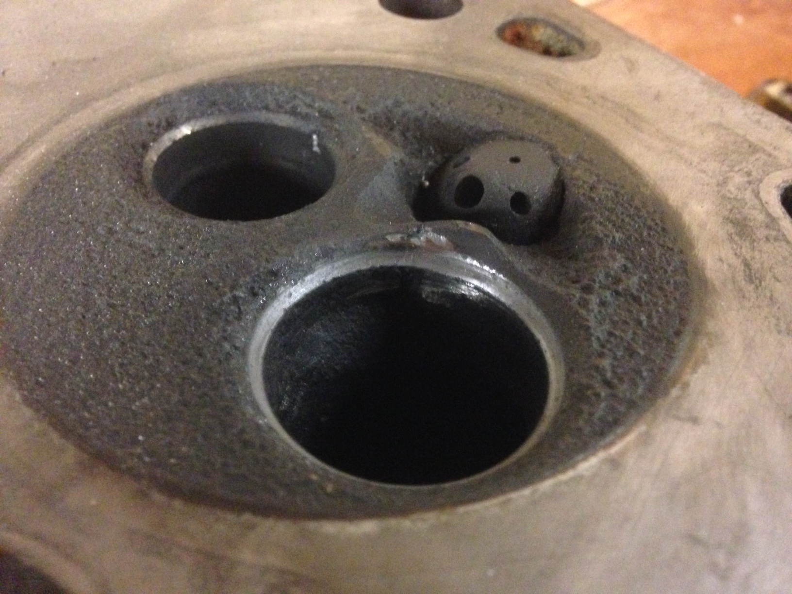

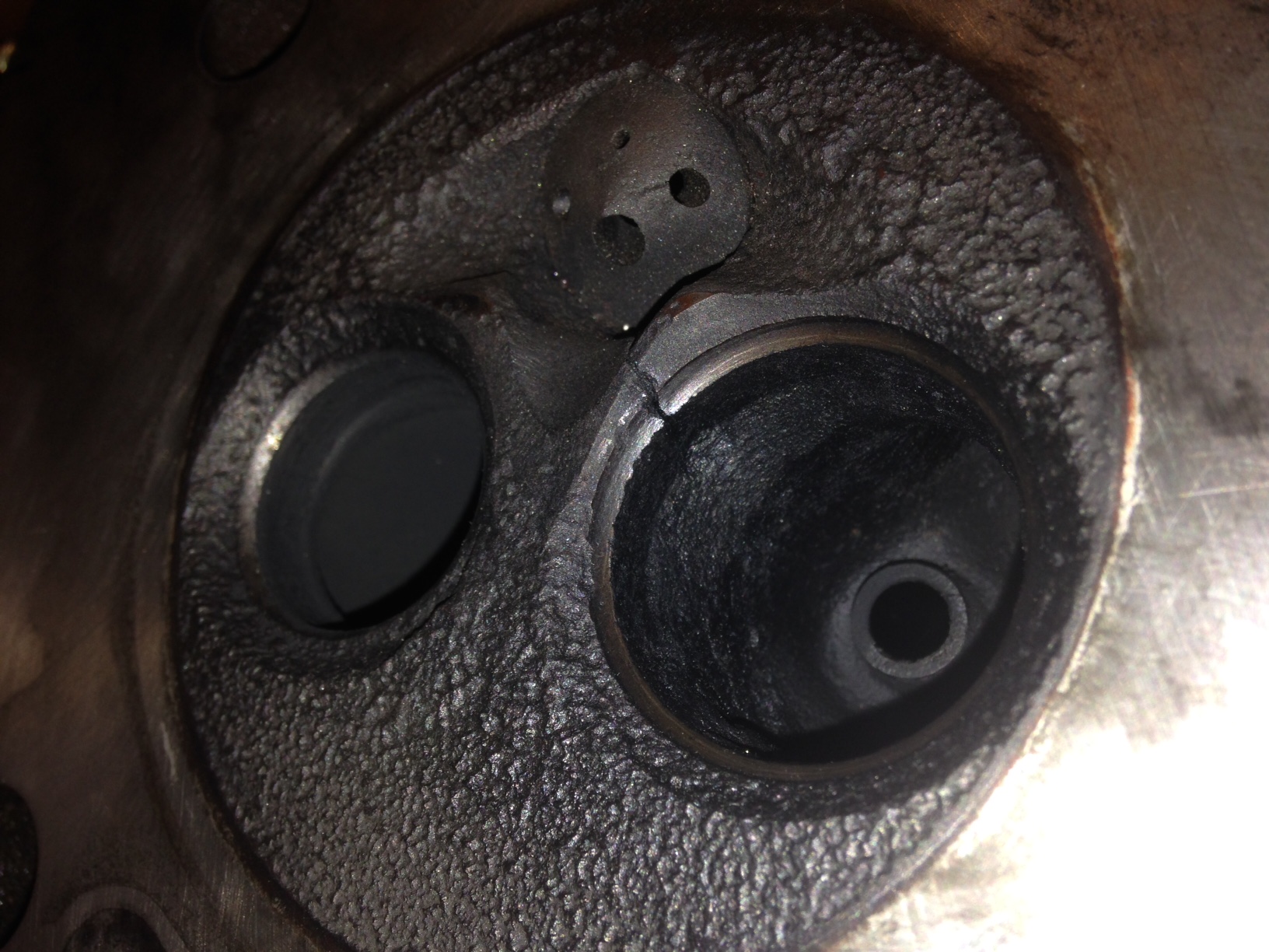

Plenty of carbon on the valve heads and some fairly pitted metal on the forward cylinder portion of the cylinder head. Once I have the valve itself out I can see just how much steel has corroded away to the point where there is a crack across the valve seat!
Great, I'm definitely way over budget for this spring's projects already without buying a whole new cylinder head. And after browsing around the interweb for a few minutes I discover that I can't find one anywhere anyway, price notwithstanding. What to do? It was a long shot but I grabbed the mig from the garage and a dremel tool...

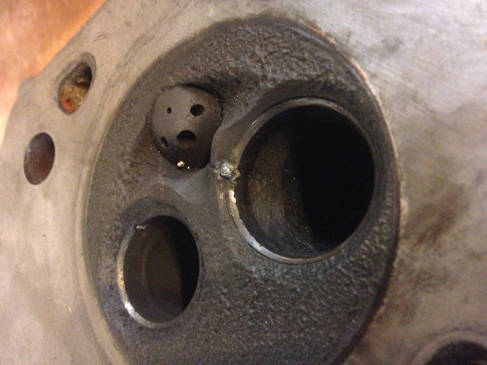

Shaping the weld bead by hand was some delicate business. Eventually the tolerances seemed close and I could finish by grinding the valve seat with the valve itself using lapping compound and this is what I ended up with.
Will it work? I'm not sure but I certainly hope so.

Josh - you're doing what I did on Rhapsody engine rebuild 2007 but I pulled the engine to do it in my basement over the winter. I had no cracks in the head. Nice weld job. The only concern I'd have with it is the surface of the weld isn't heat treated (lower Rockwell hardness than the rest of the head) and that spot may wear.
I used hammer, chisel and Dremel tool to get hardened carbon out of the water passages, then soaked the passeges with acid, once the head was reassembled to the block followed by thorough fresh water flush.
