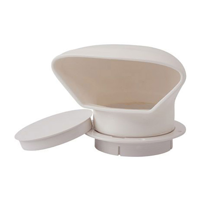

I am not yet a J-30 owner, but hope to be one soon. With respect to anchoring: The J-30 seems to be unique with it's starboard anchor well and it's forepeak rode locker. I understand the forward cowl vent/deck plate acts as sort of a hawse pipe. Seems to me if any amount of chain were to be lead in & out of there on a regular basis that the plastic ring would be damaged. Since I plan to do a lot of cruising with my J-30 I would like to hear from others about anchor deployment and any suggested modifications one might want to make to the J-30's standard "hawse pipe". Thanks in advance, Mark

You can get the 90 degree rubber "hawse pipe" (I think it is just a vent) that fits into the deck plate. That protects the ring from the chain. I cruise with my anchor on a bow roller and the chain in the forepeak. When racing, it all gets disconnected and put in a bag down below.

The Nicro or Sea-Dog flexible cowl vent works for an anchor hawse pipe. ![[Linked Image from defender.com]](http://www.defender.com/large/900939_l.jpg) I forget if it is a 3" diameter or 4" diameter hole in the deck, but either is available.
Posts: 381 |
That's the one!
