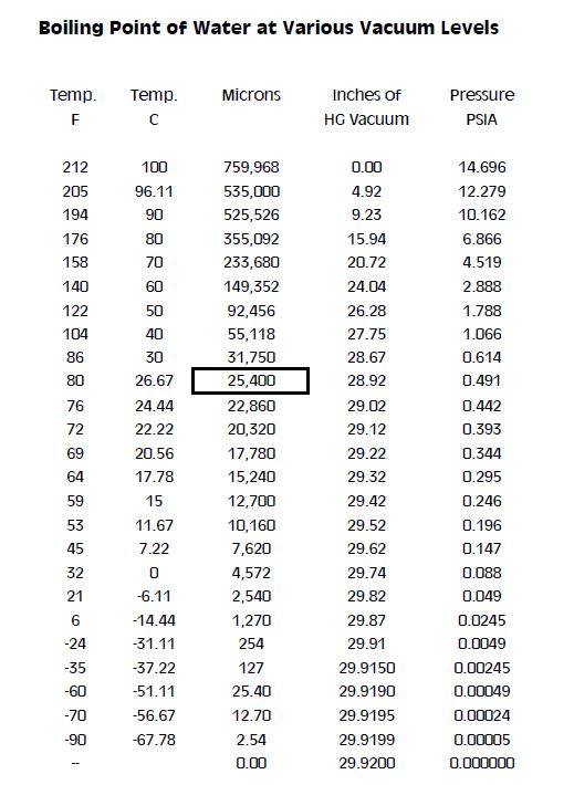

Within about 15 minutes of turning the vacuum pump on I was seeing moisture condensing in the vacuum line leading to my water collector. As I had suspected in the area I was working, I was only able to draw about 17 inches of Hg. and the pump is capable of doing nearly 25 inches of Hg. So the atmosphere is moving through this balsa, probably through the glass itself and the various small leaks in my setup. But as it moves it is picking up the moisture and taking away from the core.

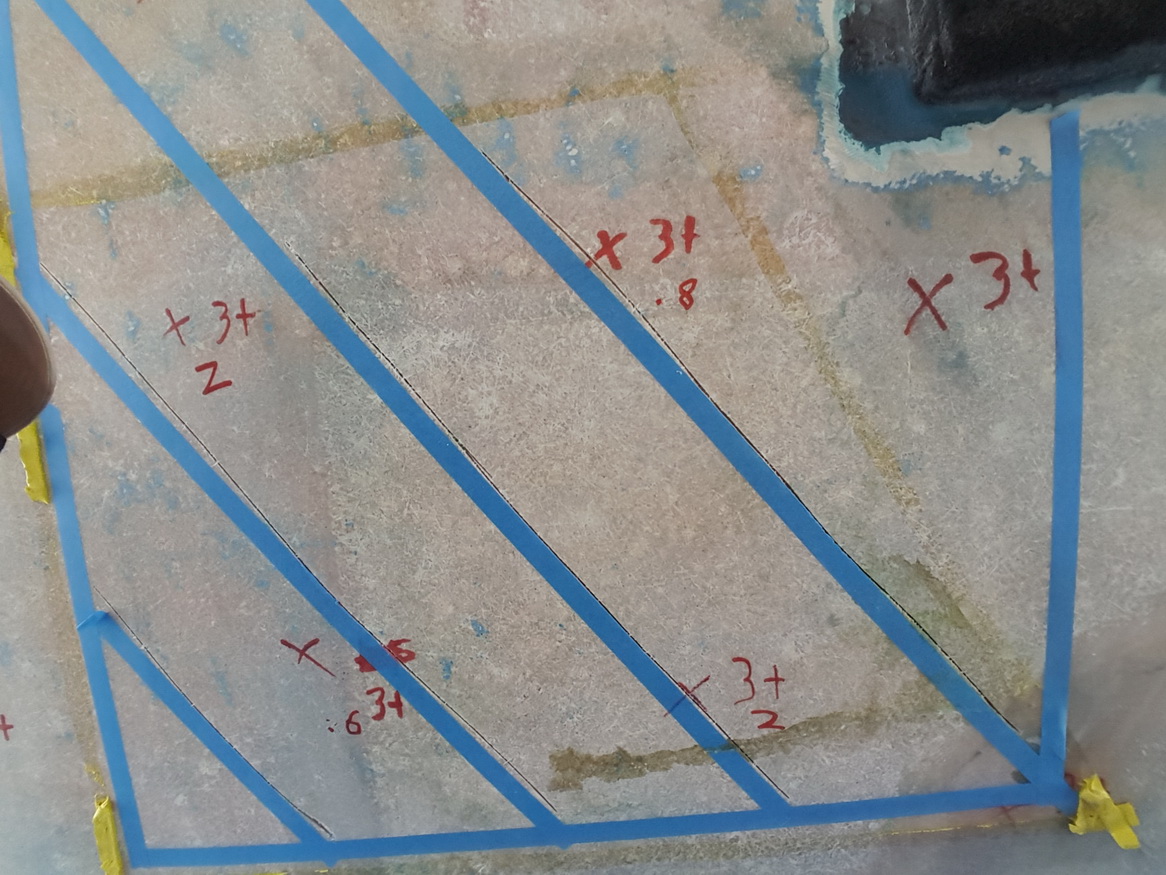

So the process goes on. As I have said this is not fast, but it does seem to be effective. The work on my part is pretty simple. 1) Cut the kerfs in the area I want to work. 2) Clean the area that the yellow sealing tape is going to to be placed. 3) Put the tape on the hull and make sure it adheres well. 4) Get a rough measurement of the size of the patch being worked and cut film oversized, cut a very small X in the center and install the vacuum port. 5) Set up your breather system and tape it in place. 6) Take the film with the port and stretch it across just one side of your patch and then carefully pull and work the edges into the yellow seal tape. Trying very hard to avoid the film needing a "dart" which is a place where you stick an extra bit of sealing tape to take up extra film. 7) Attach the vacuum line and tighten the clamp dealing with whatever material you are using to protect the vacuum line from extended high heat. 8) Turn on the pump. 9) Light the infrared heater. Or something like all of this. Anyway it is not too difficult. 10) Stay in the area so you can check on everything once in a while and make sure your boat isn't turning into a torch.
Here us a look at a recent round working on the starboard side alongside the aft part of the keel.
Balsa Core Drying #2
Video should be up a viewable about 9:30 PM Pacific
In the three areas I have worked so far I think about 16 oz. of water have been collected. Some of the areas that have been worked did have moisture values that went back up a few days after working them, but they are still below the target level on my meter of 2. The vacuum is effecting an area larger than the patch directly under the vacuum film and the saw kerfs. I will have to watch this effect and decide how to deal with the areas further from the centerline of the hull. It may be that beside working the higher levels I will have to go back and do remediation in some of the lower or first areas I worked. I am resealing the saw kerfs in the worked areas with thickened epoxy and once everything is done I will sort out a plan to rework these saw kerfs with epoxy and glass followed by filler. Finally I will be reglassing the entire bottom of the boat, someday. LIkely going to get to take a pause while I deal with some carpal tunnel repair before getting to do some serious sanding.

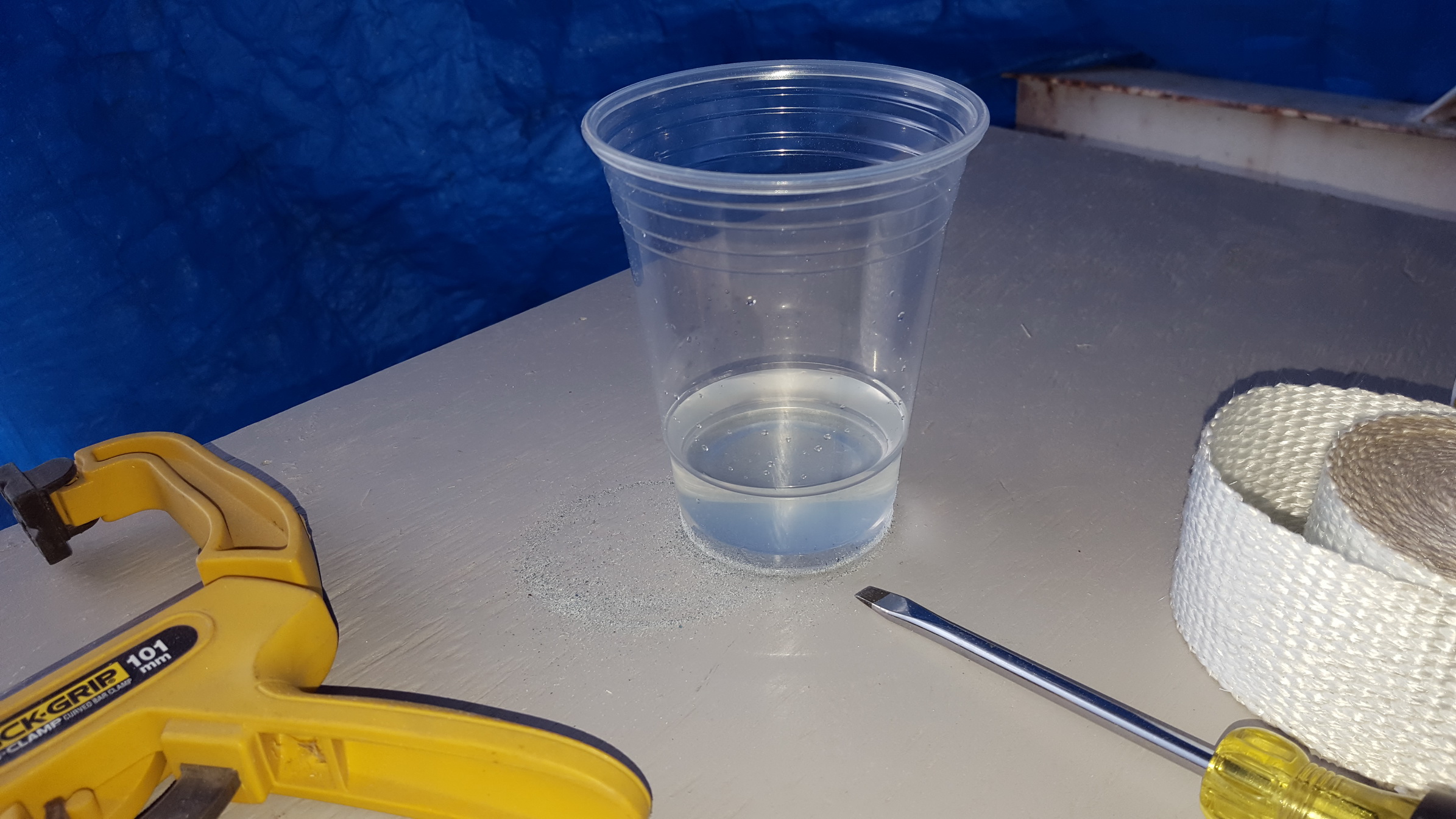

Ok, those of you following this saga I need some help from you. Today I pulled vacuum on the port side about the middle of the keel. Several things were different today. First we clearly were in a wet section of the hull. From the get go it was like sucking on a straw. I think moisture would have slowly dripped out of this section of the hull without any help. As soon as the vacuum was on there was moisture moving toward the pump even before the heat was applied. But we were also getting a much higher vacuum level than any of the other patches I have worked, in the range of 20 inches of Hg. vs. 10-12 Hg or less. I also made some minor changes to the vacuum line to keep it more open. Then I added a bucket of water to put a section of the cooling line in water before it hit the trap. So several really important changes, but the thing that is incredible is that I just pulled about 32 oz. of water out of this section in about 8 hours.
That is more water in one section than I got from the three others combined. The visual saw kerfs into the balsa don't look much different than the others I have done, nor does the apparent color of the balsa through the skin. There is evidence of either a lot of fairing in this area, or previous work, no way to really tell the difference.
My inclination is to say that this area is way beyond being dried and is in the process of turning to mush. I am OK with replacing the balsa, I just don't want to do it where it is not necessary. The advantage of maintaining the external skin for fairing is huge.
I need some operating theories before I decide to waste this outer skin and replace the core. So some suggestions would be really appreciated here. I just don't want to waste that skin if it isn't really necessary. So let me know any suggestions and ideas you might have here. I would much rather read bad suggestions than prematurely kill this skin and core. I can also go quickly test any ideas that you might have. But I do have to move through this area in the next day or so.

The water that is coming out of this patch and being collected is fairly clear, but there is some dark nasty stuff staining the breather material. I am working under the notion that black balsa is too far gone, is that the case? Or is there a better way to decide without exposing a bunch of it?
Right now I am inclined to continue cooking this patch for a while. But when I do pull this plastic off I may remove a small section of the skin, maybe a 4" x 4" piece to get a better idea of what is there. Or maybe drilling some 1/2" holes to see what comes out. I can imagine that it is possible to dry rotten balsa out if you work at it long enough.
