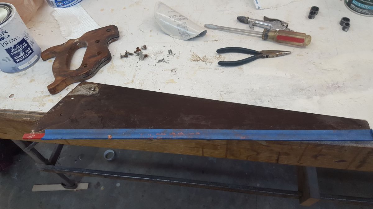

Somewhere in my wandering around the web I saw someone mention using a handsaw blade to do fairing work. Well I have several old handsaws and a ton or two of fairing work to do, so I decided to try it. I hate buggering tools up, but this seemed harmless enough and I very rarely use any of the old handsaws anyway. I took the handle off an old saw, covered the teeth up with tape and I even thought about getting the cutting tool out and making the thing have a constant width, but I decided to try it first and then make modifications if they were warranted. Well they aren't. The thing works great as is. Because the narrow end is more bendy than the wide end you can use the section that best suits the compound radius you are working.
