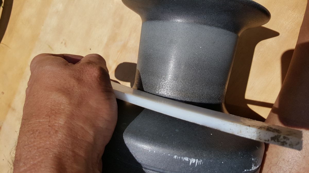

After removing the drums from the boat, i first put the top and bottom passes on the drums by holding a bit of plastic along where i wanted the edge of the new surface to be. I followed the factory edge. After doing both edges, i worked the middle out to each edge. i let the tool do the work until all the area had been repeatedly impacted.
Edging Method
![[Linked Image]](https://j30.us/ubbthreads/ubbthreads.php/ubb/download/Number/2373/filename/edging%20method.jpg)

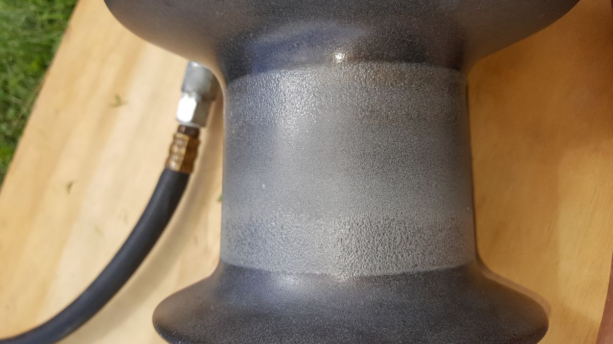

Finished
![[Linked Image]](https://j30.us/ubbthreads/ubbthreads.php/ubb/download/Number/2374/filename/finished.jpg)
i really like the new surface. On the winches where the anodizing was worn, it's still obviously a different shade. On the primaries, which did not show the same anodizing wear as the spinnaker winches, it appears the anodizing was not harmed at all with the small, flat points. However, on one winch where the tool tilted a little compared to the face of the winch, it did cut through the anodizing a little.
