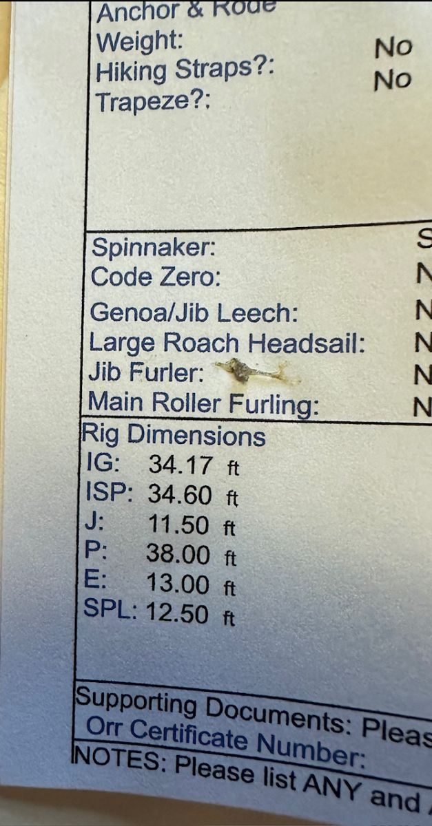

Has anyone in the fleet applied for an ORRez certificate?
I am seeing IG and ISP dimensions as
IG: 34.17 ft
ISP: 35.60 ft
Shouldn't this be the same. The height of spinnaker halyard and genoa halyard are the same on my J/30.
Thoughts?

Dave,
I think its about right. there's about 6 inches between where the jib halyard and the top spin halyard exit the mast, The forestay attaches between them.
check out this picture
from this thread
tom watson
