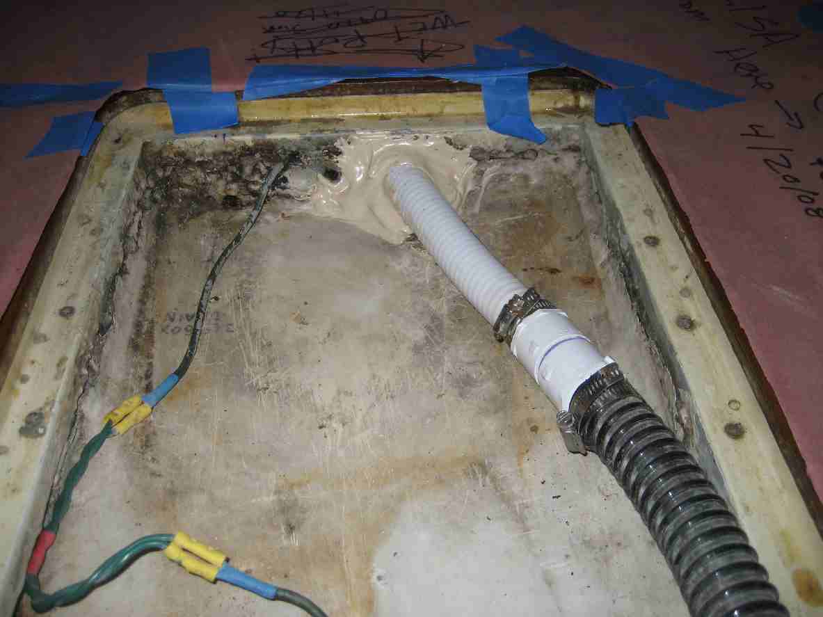

I have no ideas about the fuel situation (unless it is actually pink RV antifreeze from the block), but the hose draining into the back of the bilge is likely the ice box drain. It's known to leak.

Taras - just read this thread heading out the door to Bermuda race. I'll post a reply on the other stuff when I get back next week. Here is a picture of the bilge drain. The ice box drain is the left hole and will drain water to the bilge.
[Linked Image from j30.us]
