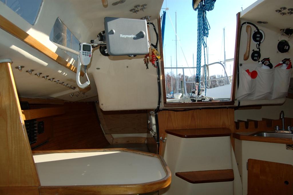

When I owned #507, just last year, I had a SS swing out arm fabricated for a Raymarine C80. The weight of the C80 seemed to preclude a RAM mount; I also was not sure if the RAM mount would really hold up when extended under the pounding possible by waves, etc. I paid $200. I thru bolted this to the cabin top and used a SS stanchion mount for the backing plate on cabin top which also fited the bolt holes for the mount base. It worked like a charm. If anyone wants pictures shoot me an email at mark-s-wolf@hotmail.com.

I don't remember the brand of the mount, but here is what the one looks like on Rauzer II; Works great for cruising, deliveries and long distance racing, but never out there for buoy racing where stuff happens too fast and getting the thing ripped off the bulkhead is a concern. One other thing, when the unit is parked inside the cabin, it is close enough to the back of the compass, that it throws off that compass about 10-15 degrees.
