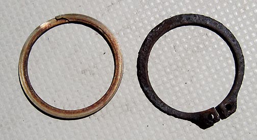

So ok ... today working on a "extension of life" program for a J24 named BANG! note I didn't say rehab.
All the winches were locked up. They used this spring clip on the left ... except for one that used this substitute on the right.
I have no idea of how to size them ... but are also what we use on some of the J30 Barients.
Anyway I got a same new replacement for the ring on the right which appears to have lasted 7-10 years ... for 15 cents.
but if i could find a cheap exact replacement for the coil ring or if someone knows the size we use, I would appreciate that.
I'm thinking the black one was what we used to call jetalized. [Linked Image]
winch retainer rings

Circlips apparently also called Spiral Retaining Rings.

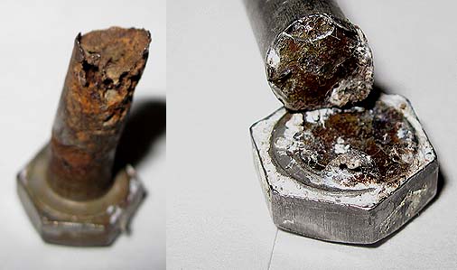

And as your reward ... what happens to #10 SS bolts used years ago to anchor stanchions in a J24
they are still non magnetic, and the one with the head popped off looked good enough to reuse but was rotted in the core ... duh...
Vic - Stainless does not mean it won't rust. You are seeing evidence of a possible combination of:
1. Substandard quality steel (e.g. maybe cheap Chinese knock-off without quality control for the alloying process)
2. Stainless immersed in water with no oxygen
Stainless works if there is a source of Oxygen, e.g. areas that get wet and dry or are permanently dry. Otherwise you get accelerated crevice corrosion because there is no oxygen source to continue to build the passivation layer.
With the wet core, the ss bolt was in constant contact with a source that had no oxygen, hence the result you see in the picture. More reasons to make sure all holes are epoxy isolated!
That is a reason that Monel and Marine Bronze is better suited for use below the waterline.
