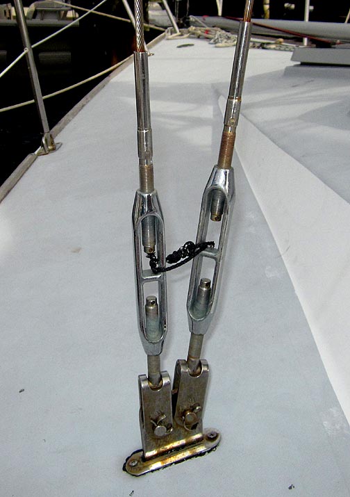

It is the style with the screw in the center. Mast came from Hall through Annapolis Rigging who did the shrouds. Replaced the center screw when the square part in the middle became too loose to allow adjustment. Also noticed later that one of the two screws had a bit of bend.
[Linked Image from navtec.net]
Roger, roger ... I think that was the reason Hall upgraded to the larger turnbuckle. But before you think I am endorsing Hall they built me two forestays a week apart when I upgraded 505 and 526 roller furlings ... and they were built to different specs. One fit fine and the other we had to customize with a grinder because of different fittings.
But the turnbuckle I have on 505 is the one photo in my post above and as you can see is big screwdriver tune-able.
