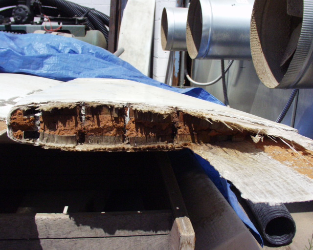

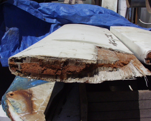

John McArthur (Smiles) copied me on an email to Jason with pictures of the broken rudder, allowing the core and construction to be seen. I've posted the information with pictures below for all to see.
Quote
Jason,
Here's some pictures of a "Failed" J30 rudder from IdaSailor. IdaSailor made as rudder for me last year. Most of the J30 rudders I have checked out are in the 70 to 80 pound range "Wet". IdaSailor's rudder I purchase was 40#.
Bill, I talked with Joel at Ida Sailor and he thinks it would be easy to make the new rudder weigh around 55-65#.
John McArthur
Hi John,
sorry for the delay, had to dig the rudder pieces out from under a pile of other broken blades.
Weight for both pieces is 53 lbs.
Thanks for business and your patience. I look forward to hearing the results of your class measurer and your experience with the rudder under sail.
fair winds,
-Joel
Joel Santarone
General Manager
IdaSailor Marine Inc. www.idasailor.com
866-400-2204 toll free
208-375-2204 shop
sailboats@idasailor.com
[Linked Image from j30.us]
[Linked Image from j30.us] [Linked Image from j30.us]

I cleaned the balsa and ground down the rough edges on the glass...so I'm ready to start rebuilding.
A couple notes worth mentioning after looking at the broken rudder:
1) The rudder has a foam core (i think) that is shaped, then has balsa wood wrapped around this "shape". The balsa wood is uniformally 2 sizes:
a) 1/4 inch balsa between 3.25 and 5.25 inches from the trailing edge (it's not shaped and is uniformally the same thickness).
b) 1/2 inch balsa 5.25 inches from the trailing edge to the leading edge (it as well is not shaped and is uniformally the same thickness).
2) The balsa wood was so rotten that using the claw on a hammer I could just pull the balsa off...no chissel was required this time.
