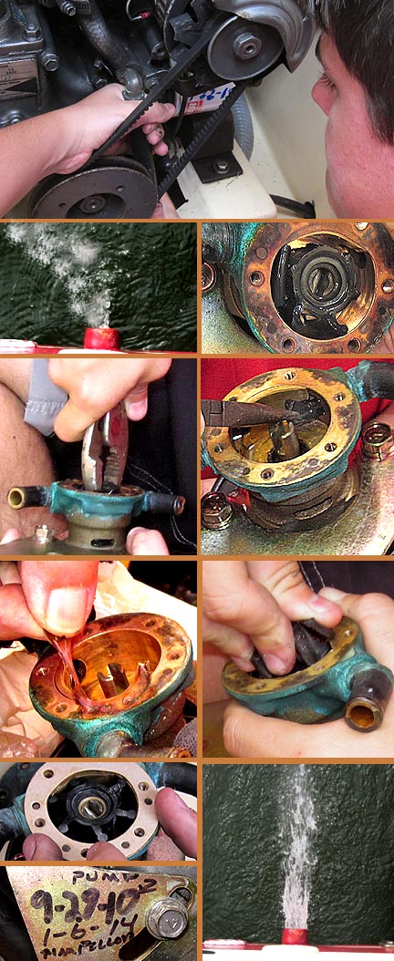

Nothing like puffs of steam to tell you that the impeller has had it. In Naples impellers apparently last 3 seasons. TK in charge. ![[Linked Image]](https://j30.us/ubbthreads/ubbthreads.php/ubb/download/Number/1702/filename/combo.jpg)
