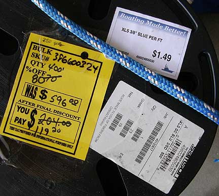

d. how do you temp fix this in a backwater non sailing oriented environment like Naples? kiss off the wire halyard with 100 feet of whatever cheap 3/8 line you can find ... in this case Sampson XLS from a final bankrupcy sail last year at Boat World at 80% off ... only problem is now my spin and main halyards are the same blue line.
